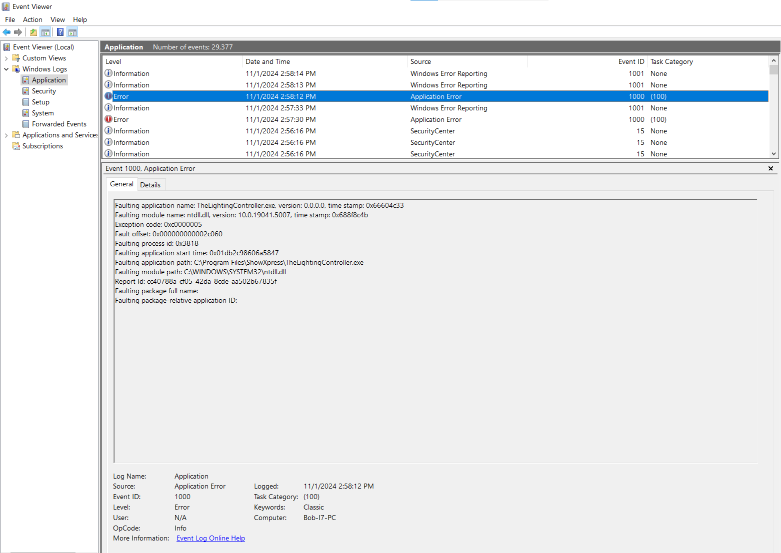

I was working on my lightshow the other night on my desktop computer, editing an existing lightshow to add another light, a ColorKey Droid FX. ShowXpress was working fine until I tried to duplicate the ColorKey fixture, and it seemed like every light in my fixture window was copied after the ColorKey, but was greyed out out looking, then the program suddenly just crashed! Every since then when I tried to run it, it tries to load and suddenly crashes. I looked in event viewer for windows 10, and it shows the ntdll.dll might be responsible or maybe thelightingcontroller.exe as well. I have tried doing the following things to resolve this, with no avail:

I am at my wits end and was hoping you might have some insight to what might be happening. The program crashed and caused some kind of error but I cant figure out how to resolve this. The computer seems to run fine and other programs I have tried seem to run ok. Could your newer version of ShowXpress be causing this? I am attaching what event viewed shows, if this helps any. I am sure you'll want more details but don't know what to add. My computer is older but works fine, Windows 10 Professional, 1st gen Intel I7 with gigabyte P55A-UD3P board, x64 based pc, 16 gig Ram, 1 TB SSD drive, Nvidia GeForce GTX 1660 Super

The file "ntdll.dll' is not related to our software ; this is an important library linked to the Windows Kernel.
This explains that re-install our software will not change anything.
It looks like the problems comes from the operating system.
