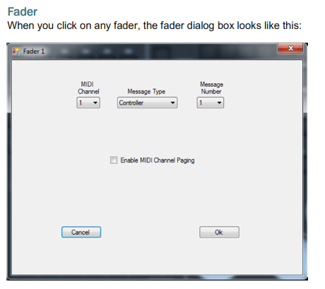

I have the Elaton Midicon2 in use, together with ShowXpress. I would like to use the fader pages on the Midicon to use more than 8 faders. How can I configure this? Can I do it directly in ShowXpress or do I need the Midi Mapper software? Unfortunately it did not work with the learning button. The page is ignored.

The problem is solved.
With the Midi Mapper software from ADJ Midicon the paping can be enabled. After that process everything works fine.
