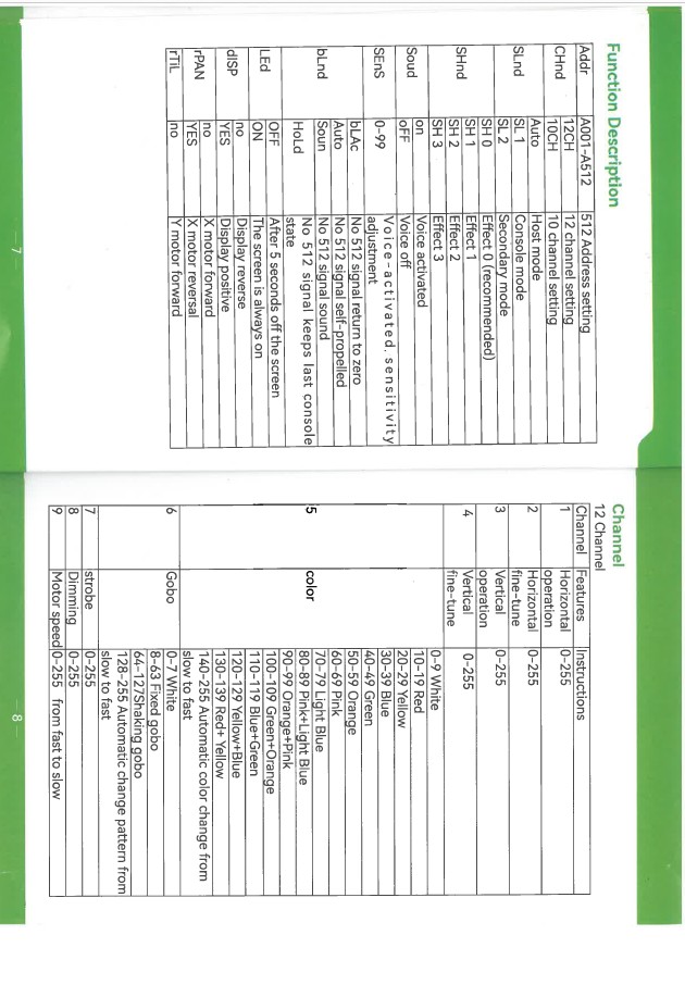

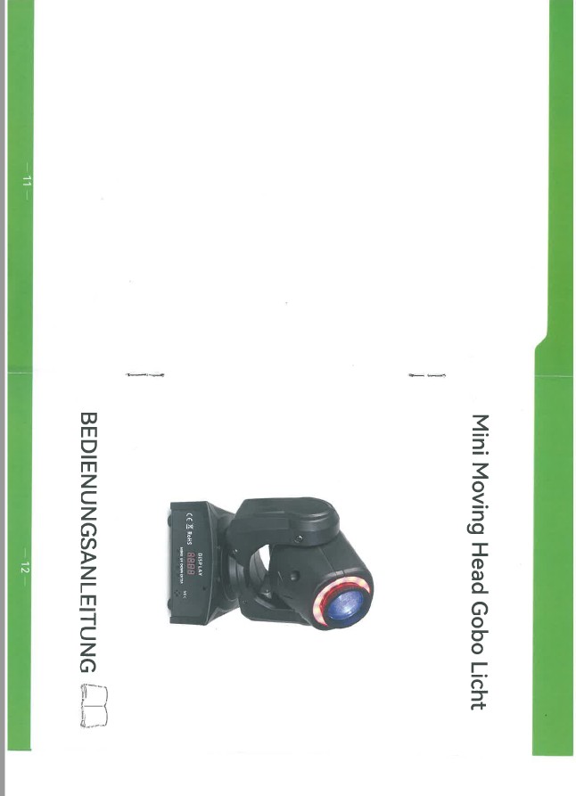

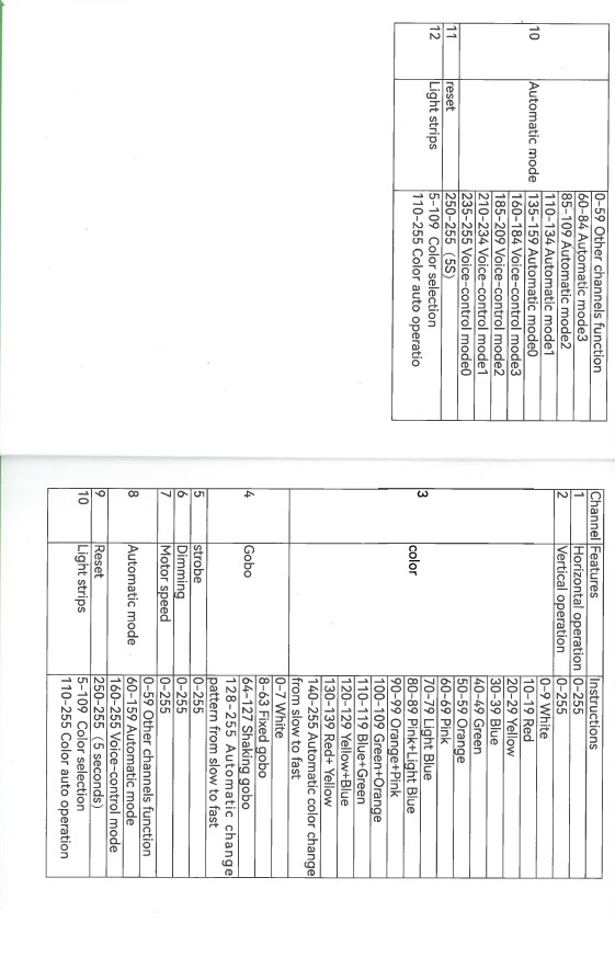

i'm a newby so thanks for accepting. I've this problems with my mini moving head gobo lights. I've got 4 pieces. I can't find the right ssl2 fixture file. its a mini moving head with a led light ring. 10/12 ch DMX.
i ve searched the database till 2020 but i can't find it.
Can you help me?
Thanks in advance.
gr. Joris

The profile is done.
