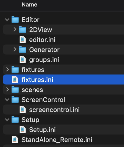

Well, there isn't a thelightingcontroller.ini file...
Here is a screenshot of the folder structure (not everything is unfolded).

Re: Working with old lightshows
Weird !
So no way to know the software version.
The date of the created scenes may help (?)
Otherwise, you will find the old major software versions here: https://forum.thelightingcontroller.com ... php?t=4553
You can install each of them and check whether they are able to run correctly your lightshow.
Very important: please make a backup of your lightshow before doing these tests.
It may be necessary to do each version check with the original lightshow.

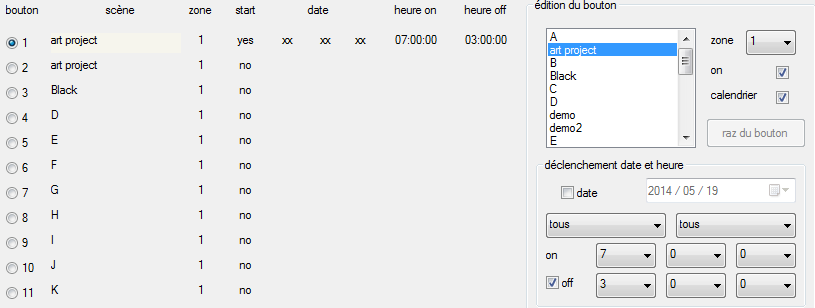

But I'm still not sure what software was used by the person who programmed the sweetlight remote. I've got a screenshot the person did of the software, but it does not correspond to any window I can see in any version of the software. I'm posting the screenshot here.
@support Should bring them back here.
