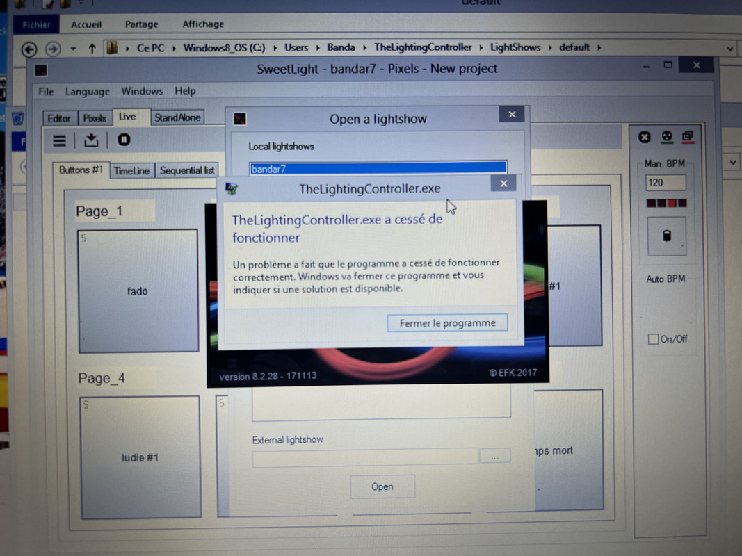

So... i've advanced. Managed to install v8 on windows 8.1 (where my V7.1 is installed). I managed to open it and I see that v8 recognizes v7 lightshow. (I had to rename the TheLightingShow folder of v7 to 'OLD' in order for v8 to start up). HOWEVER, the v8 will crash upon loading when I load my v7 light show.
See image Image
Any idea why?
Thx,
BR
Posts: 11427
Re: Export V7.1 lightshow to V9 to Rack1024
Please post a link to download a ZIP of your lightshow.
We will try to check that.
