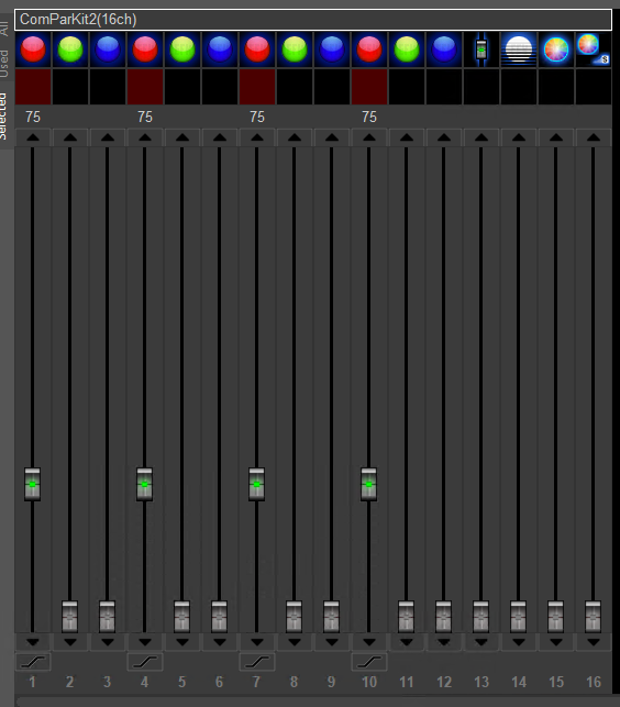

I have Ayra Comparkit 2 and it works perfect. But when I control lights all lights are the same.
So if I want red all lights went red.
But is want different colors for each par.
Please see attached screenshot. If I move slider for LED1 , LED2,3,4 are also moving. How can I fix.
Thanks in advance
Kind Regards,
Patrick
Steps Scene Screenshot
Posts: 11427
Re: How to control par individualy
You have to switch on the button "Ungroup channels in fixture" (the eighth button from left side) in the tool bar.
