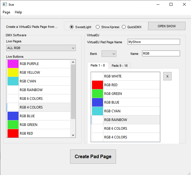

I am working on a Windows/Mac application which will create VirtualDJ Pads Pages with your Live Buttons, useful if you want to control your Live Buttons via the Pads of the same MIDI Controller that you use with VirtualDJ.
You will just have to OPEN the Live.ini file of your show and then drag from left side list and drop to a VirtualDJ Pad on the right side.
The Pads will get automatically the color of the Live button (for RGB MIDI controllers) and their Display texts can be edited (instead of the Live button name)
You can have up to 8 Page Banks which will be cycled via the Pad Page Parameter buttons
For Controllers that have more than 16 Pads per side (such as AKAI APC Mini, Novation Launchpads etc), there will be an additional mode in the App to directly map their buttons , because VDJ supports up to 16 Pads per Page.
Will post further details once done.
Feedback is welcomed.
