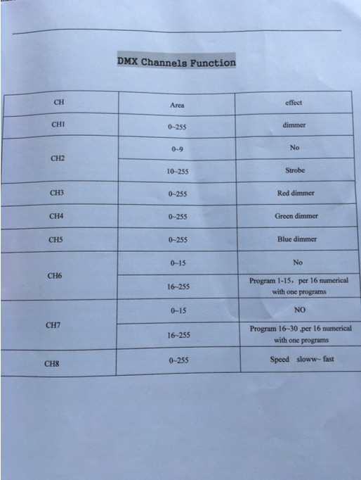

I attached images of the addressing since they could not provide a link. Thank You

Done.
PS : we were not able to do all perfect, because some dmx levels are not specified, and we need a PDF format to copy/paste the text.
