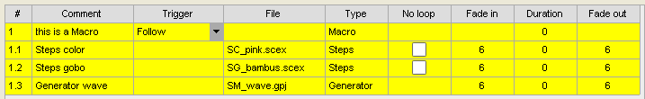

Sorry but it is not possible to convert a Macro into a scene.
However, if you really need to convert some scenes into one, please read this: viewtopic.php?f=70&t=4367
But keep in mind that, once the conversion is done, the purity of the scene (especially for Generator & Pixels) is lost.
Please note also that there is no limit for Macros.

Please keep in mind that, generating a scene is "destructive". This means the result will not be as accurate as if you play all original scenes together.
This is why we do not push for this concept, and we prefer to advise using Macros (all sub-scenes can stay in hidden pages).
Another key point with Macros is, if you modify an original scene, the Macros will be automatically updated.

The only issue for me is that Macros cannot be used in Sequential List function. This is paramount for building a proper scripted show. The only thing I've done so far with generator is to create a moving light generator file, converted it to a scene file as directed, and then added other fixtures to the scene and then placed in Sequential List. I do not use Generator for any non-moving fixtures.
Eric Tomlin
Production Director
Bridge Community Church
Posts: 11452
Re: Multiple Scenes Stacked to form one scene [fixed]
It is possible to create Macros in Sequential List.
