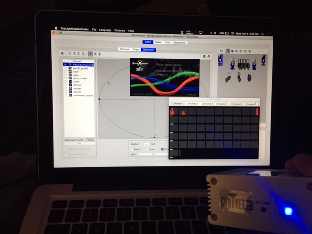

Posts: 11453
Re: NO PC Link
Do you read "interface xxx found" in the welcome screen, with software V8 ?
(you can call back the welcome screen with "main menu > Help > About")
djronge
Posts: 7
Joined: 07 November 2016, 19:46
Re: NO PC Link
Post by djronge »
Yes, It states, 1 interface found Xpress512
djronge
Posts: 7
Re: NO PC Link
Post by djronge »
Here is a snap shot of the interface connected with DMX turned on, DMX BarGraph, Generator playing, and the PC Link light inactive.
Screen Shots, D512 PC link Status light inactive
