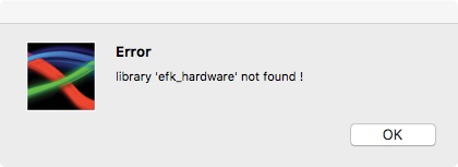

The first problem is Sierra has a the new protection level.
Without telling you, Sierra moves our program into a sandbox. Then it logically does not find the library. The result is this window:
For more infos, please read this: https://www.tekrevue.com/tip/gatekeeper-macos-sierra/
It is however possible to install our current software version, without having to disable Gatekeeper, by importing our software (the DMG file) from somewhere else than from internet (for instance from a usb key). Our next DMG files will be signed, so this problem will not exists anymore in the future.

First problem is fixed in V8.1.29.
