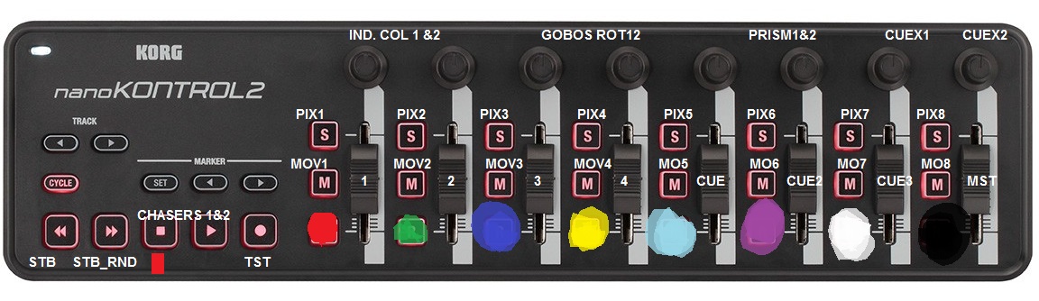

Concept using Korg NANOKONTROL 2 If you have questions about how i label this... (specially TST = Test Scene, moving heads in middle and white, for testing my patch
- MODE.jpg (136.18 KiB) Viewed 26688 times

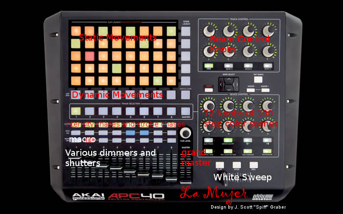

Hello, I think may have the same ideas in a lot of ways.
Here is my layout called "La Mujer". This relies on some special techniques. For ideas, You can download the show that I use with it here:
http://www.spiffsmpo.com/LightingDesign.html
Check out pixels if you download this show. I have included numerous pixels projects using pallets gleaned from http://www.colourlovers.com. Easily evident is my special technique for handling CMY fixtures to make them behave the same as the RGB fixtures.
The Software's use of MIDI is a truly incredible feature. Now with MIDI sends, I can trigger video software, lasers, or really anything from the live screen. Beautiful!
I used a Korg NanoKontrol for a few years experimenting. I miss the ability to set up the controller with the APC40. The Korg is very configurable. Play around with using "Flash" buttons in live with latching buttons on the controller. Careful though. It can get to where it's very hard to use without controller, and you know what happens if it gets unplugged...
Make it bright,
Spiff

- I have other postings about La Mujer. She's a beauty.
- La Mujer APC40 layout.jpg (56.79 KiB) Viewed 26587 times

Hey,
How did you assign colors to the knobs? that would be HUGE for me. I have your project and the controller only 6 moving heads and 4 pars but I would love to ask you a few questions. Send me an email if you have the time. claydoggett401"at"yahoo.com (replace "at" by @).
Thanks
Thanks
Re: Show Us Your MIDI Setup!
its easy... you only need to set up a scene with a colour in each step... then you only put as a prset button, map it to your midi knob... and thats it!
