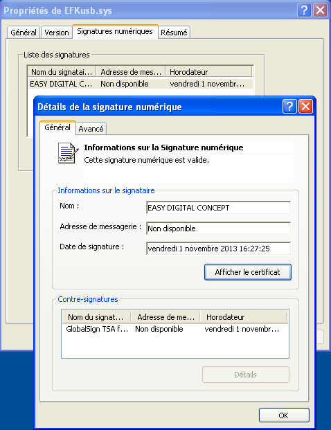

Re: D512 Driver Problems under Windows 8.1
These revised drivers are signed.
You can check that with a right click on the files and the menu "Properties".
- drivers_32bits_W8.png (32.54 KiB) Viewed 30867 times

As far as your example with the EFKusb.sys is concerned: yes these files are digitally signed, but the problem
seems to be the D512_32bits_V104.inf setup file, which hasn't even got digital signature properties whatsoever.
At least they're nowhere to be found when right clicking it and selecting "properties".

The existing 64bits driver is supposed to be Windows 8 compliant (signed sys & dll files + signed catalog file)
The existing 32bits drivers is not Windows 8 compliant (first time we hear about a 32bits Windows 8).
So we added sys & dll files signature + catalog file to the 32bits beta driver, same as we did for the 64bits driver.
We know that Windows 8 makes the maximum to block drivers who do not pay the Micro$oft licence, but since it works under 64bits OS, it should work on 32bits OS to.
PS: an INF file can not be signed (this is a text file, not a binary file).
