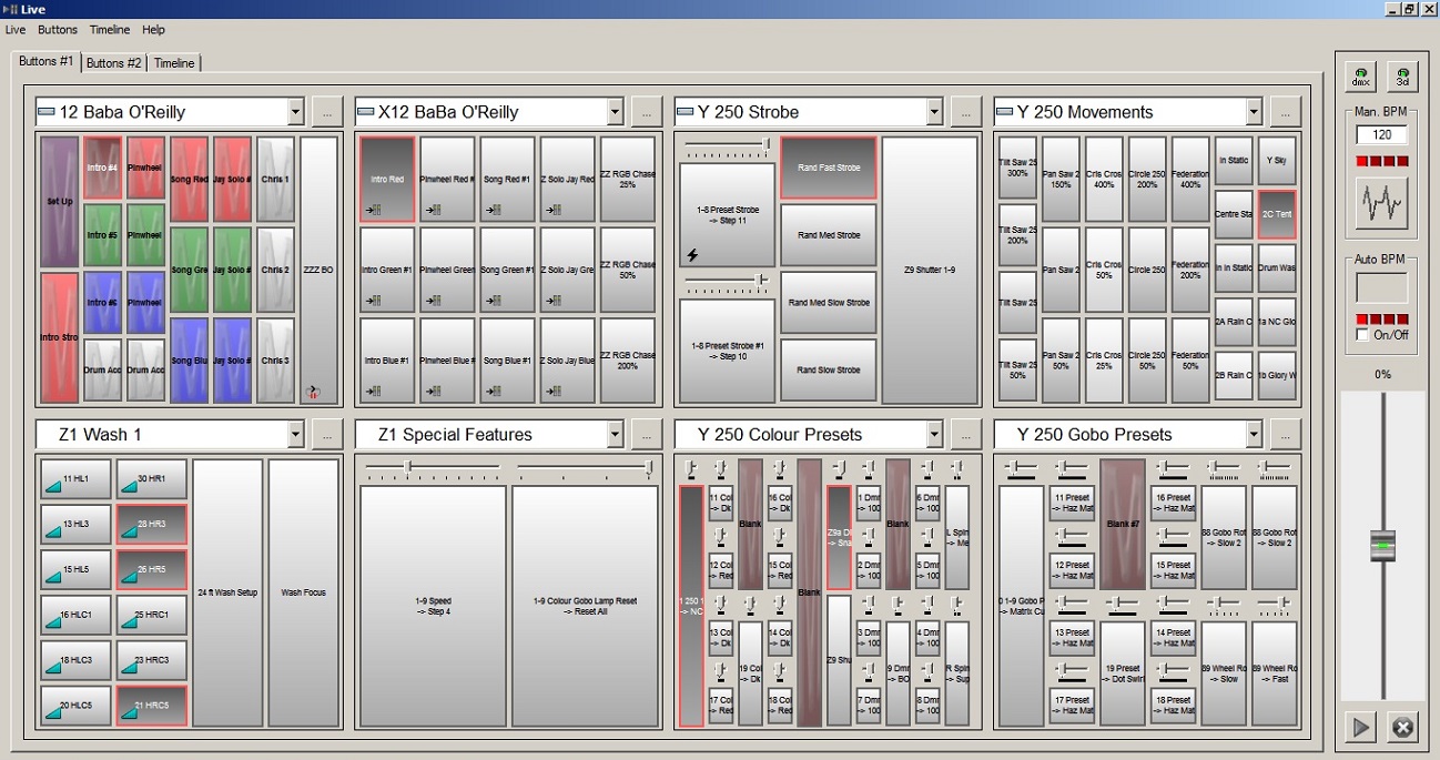

This is my first page that I work with prepared songs

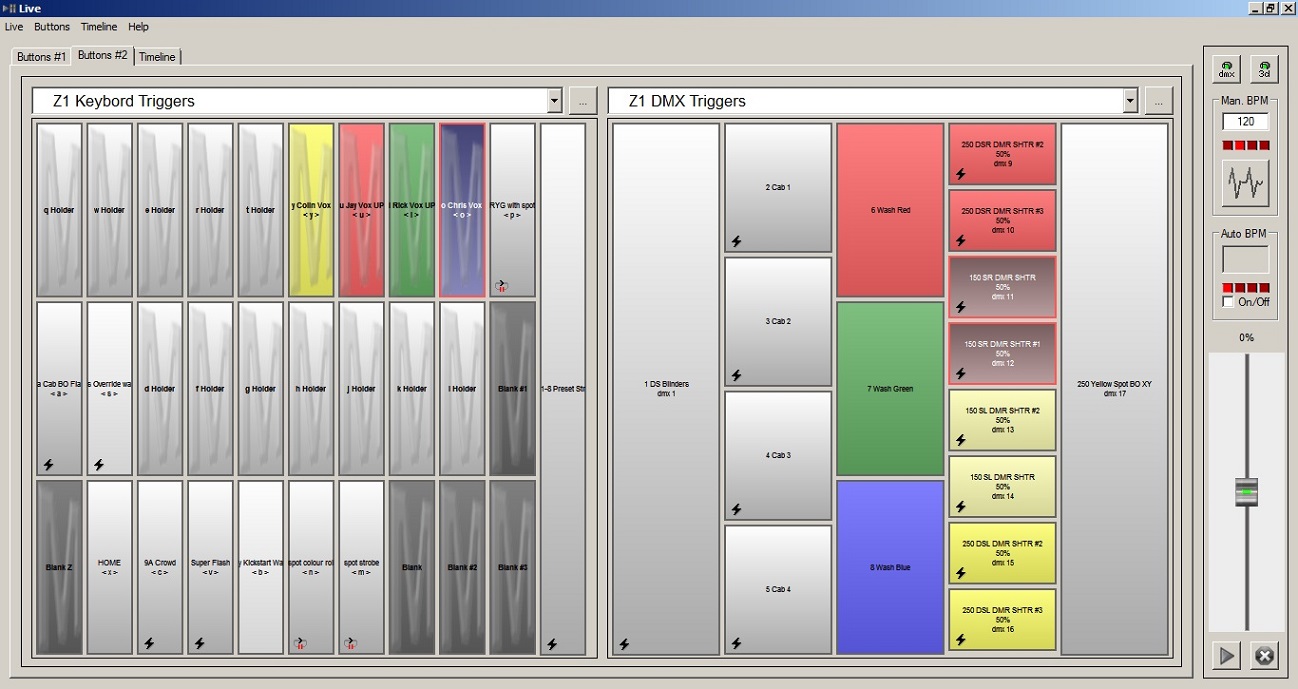

This is my page 2 and a lay out of my keyboard and DMX triggers

I use presets, macros, keyboard and DMX triggers. I work with a 32 channel NSI MC 7016 wing console.
I have worked with this band for 8 yearx and have been running their light show with software for 3 years. I have had the usual problems here and there but nothing I couldn't fix. The guys I work with play 3 to 3 & 1/2 hour shows without a break. So my lights have to work and the software bulletproof. I do 50-80 shows a year with them.
In this show I run 24 LED P64's (12 US, 12 DS). 6 Intimidator 250 LEDs US, 48 pinspots patched into 8 groups/8 channels, and 2 Molefay (crowd blinders)
2 Intimidator LED 150s as DS vocal follow spots patched down to 2 handles each and then focus positions are done hot and live, then saved to a submaster.
2 Intimidator LED 250s as DS solo follow spots patched down to 2 handles each and then focus positions are done hot and live, then saved to a submaster.
My wash RGBs are patched to 3 faders for R, G, & B. I then submaster those three to a handle, as well as submater a mix of all three for a NC handle. This allows my to mix the wash manually as I wish and then I have keyboard triggers if I wish to just bring certain artists out in NC and not use a spot. And in certain songs I have the software in control of the wash for dual colour washes, strobes or other special features.

Hi, nice Setup!
How do you access the fader buttons in e.g. the "250 Colour Presets"? Do you have a hardware link for there? What do you mean by Submasters? Do you have any additional hardware except the dmx wing console?
