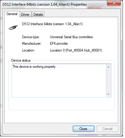

I assumed this was as all USB ports are USB3 - I've tried upgrading the driver and can see this was successful in device manager:
Device Manager
Device Manager
but I still get the same error. (this is exactly the same error - and I have rebooted)
