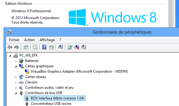

We just checked.
It works here.

Posts: 11170
