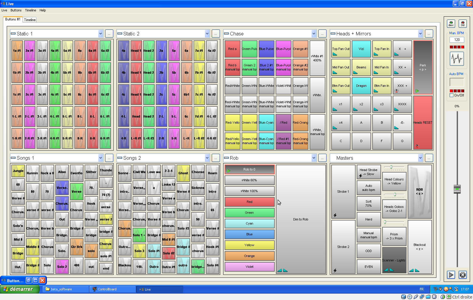

Most of my live sets are built-up of macros made from stock scenes which tend to live on Page 2 of buttons.
Static 1+2 are generic macros. typically working top to bottom for any given song - Usually starts with an intro scene and works through verses, choruses, solos etc. - Heads and Mirrors can be added at any time and stored with the macro or not.
Songs 1+2 again are macros and work top to bottom and are specific cues for specific songs during the set.
Chases give me 2 options for each chase scene - Top chase is a fade and usually gives me a transition of about 1.5 seconds between steps. The second chase uses the same scene but the button speed is set to "Manual BPM" so I can tap sync.
The window labelled ROB usually controls the spots on the band front man and I tend to use this along with the chases.
It may not be a conventional way of working but it works for me. Hope it may give somebody ideas or inspiration :D

Thank you (lot of buttons indeed).

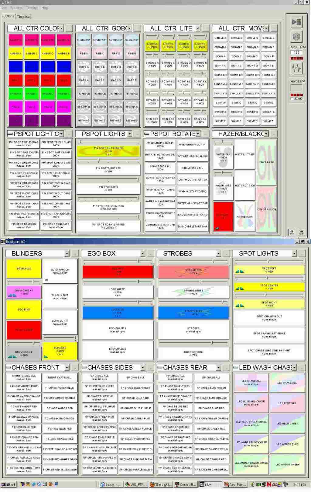

Buttons page one: I run this on mylaptop screen.
Page two on second monitor.
This was from a recent show where we mostly busk each set.
32 foot main truss with 7 chauvet moving heads, 8 par 64's, 5 par 56's as spots,
and 12 chauvet led pinspots on the house side of the truss.
Back of the stage i have arch with strobes, chauvet led pinspots, and small cans on the drummer.
24 channel "wing" board softpatched in to control the pars, and some of the other lighting.
I could really really really use a third page of buttons, or ability to go 10x2 on the page.
Not shown: 2 other scanners, 4 different lasers, and par can control.
The page with the moving heads i wanted to be able to control them in groups, so i can
select "ALL" "Center" "Odd" and "Even" for differnet looks.

STREWTH! and I thought my buttons were crowded.
I agree, a third page could store rarely used scenes and made active when needed. That would free up other windows for regularly used scenes.

Shakes, yours are crowded!! But, a glance at them tells me you have them in a logical order, one that you could probably teach me fairly quickly.
I think I could do the same with mine to you.....
