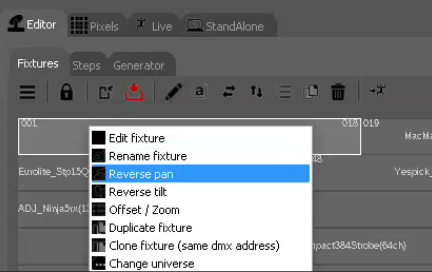

I have previously had my moving heads mounted upside down but am now turning them upright.
Is there an easy way to change all the settings for them on my steps and generations to flip everything upside down at all please?

Please try the options "Reverse pan / tilt".
