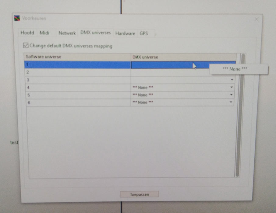

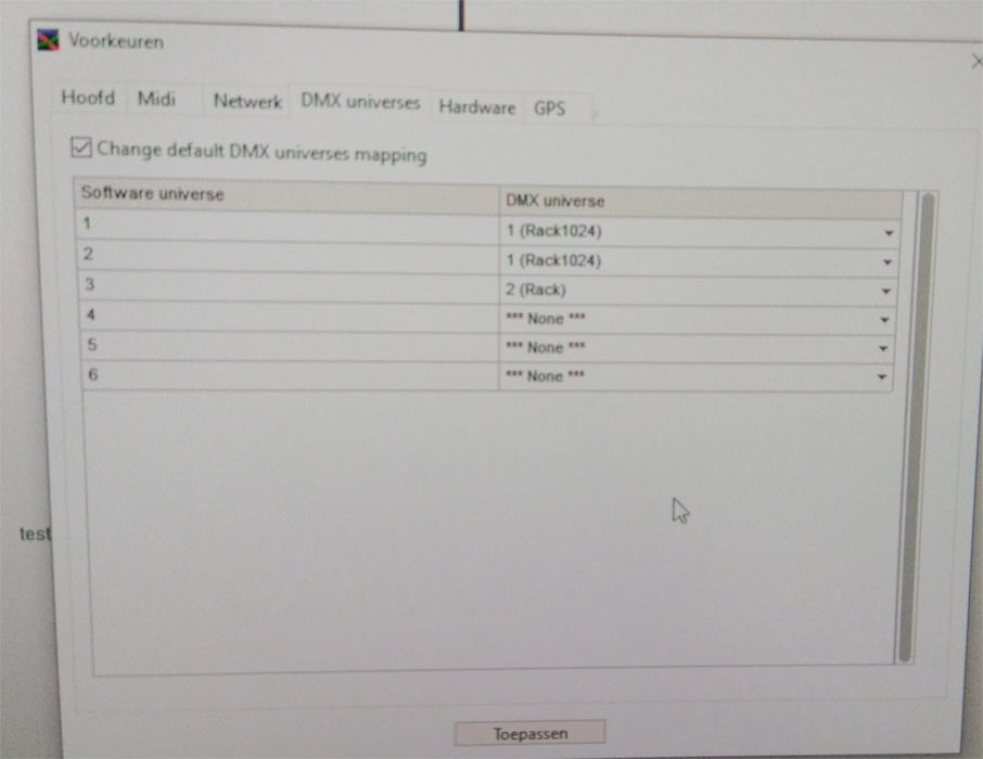

Hello!
Since last update 9.4.3 I can't select a universe. At preferences, DMX universes, I see a dropdown, but all options are empty.
On the previous version it worked fine. I got a Rack1024 and a Rack installed (so 3 universes)
Is this a bug?
9.2.38

9.4.3
[image]
Posts: 11419
Re: Since new version Jan 2026 cant select universe
We are able to reproduce the problem.
We will work on it asap, and we will keep you in touch.

If I may add, maybe I should start another topic for this.
But if I add a Rack1024 with 2 universe outputs, it would be nice to see Rack1024-1 and Rack1024-2 for instance, or A and B.
Now you just see 2 x Rack1024, which is a bit confusing to me. In some cases I would like to know which output i am actually selecting.
Thanks
Posts: 11419
The problem is fixed in the new version 9.4.5 (https://forum.thelightingcontroller.com ... php?t=8585).
The first line showing "Rack1024" is always the first DMX output of the DMX interface.
The second line showing "Rack1024" is always the second DMX output of the DMX interface.
This can not be changed.

Ok, just to be sure.
In case you select universe 2 first and choose rack1024, and select universe 1 and choose rack 1024. Is the first DMX output always on universe 1, or is the first DMX output on the first selected (in this case universe 2)?
Thanks
Posts: 11419
Re: The "DMX universe mapping" menu is empty [fixed]
The first line from the top showing "Rack1024" is always the universe 1 of the "Rack1024".

Bug is solved btw, the update works perfect!
