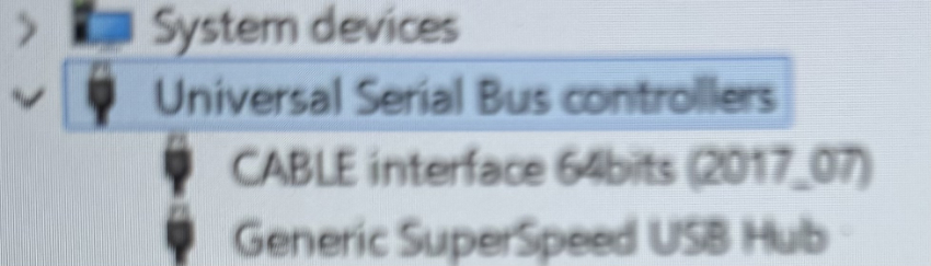

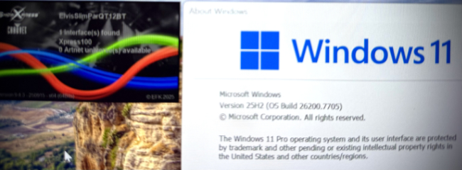

Thanks for that. After doing multiple testing on windows 10 & 11 newer laptops, I finally got it working in windows 11 this also appplies to the newe laptops in windows 10. Hopefully this might help others.
Installed Showexpress 9.4.3 on Windows 11 Version 25H2
If you disable driver signature enforcement. By running a command prompt as admin.
Cmd <Enter>
Bcdedit -set loadoptions DDISABLE_INTEGRITY_CHECKS
Restart and then try to install the DMX to USB Driver in Device Manager.
I used 2017_07 and it installed it correctly.
NB: If you still have issues you may need to disable Secure Boot in the Bios
One other thing i did was disable bitlocker as well.
That’s it all lights, smoke machines & moving heads functioning correctly.
Device Manager.jpg (138.73 KiB) Viewed 64589 times
