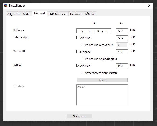

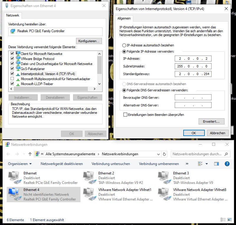

ich habe folgendes Problem. ich bekomme das Artnet nicht zum funktionieren.
Die Anleitungen hier im Forum habe ich alle befolgt und ausprobiert.
System:
-Win 10 pro.
-QuickDMX 9.3.21 x64
-D1024 Interface ( 2Universen Aktiv, 1x Artnet (electroconcept Node1) soll als Universum 3 dazu.)
ich weis leider nicht weiter und hoffe jemand kann mir helfen wo das problem liegt.
Google Translate :/
Hello =)
I have the following problem. I can't get ArtNet to work.
I've followed and tried all the instructions here in the forum.
System:
-Win 10 Pro.
-D1024 interface (2 universes active, 1x ArtNet (electroconcept Node1) should be added as universe 3.)
Unfortunately, I don't know what to do and hope someone can help me figure out what the problem is.
thanks a lot

You have to set the Artnet IP of your device (2.0.0.1 ?) in the "Fixtures" module of the software too.

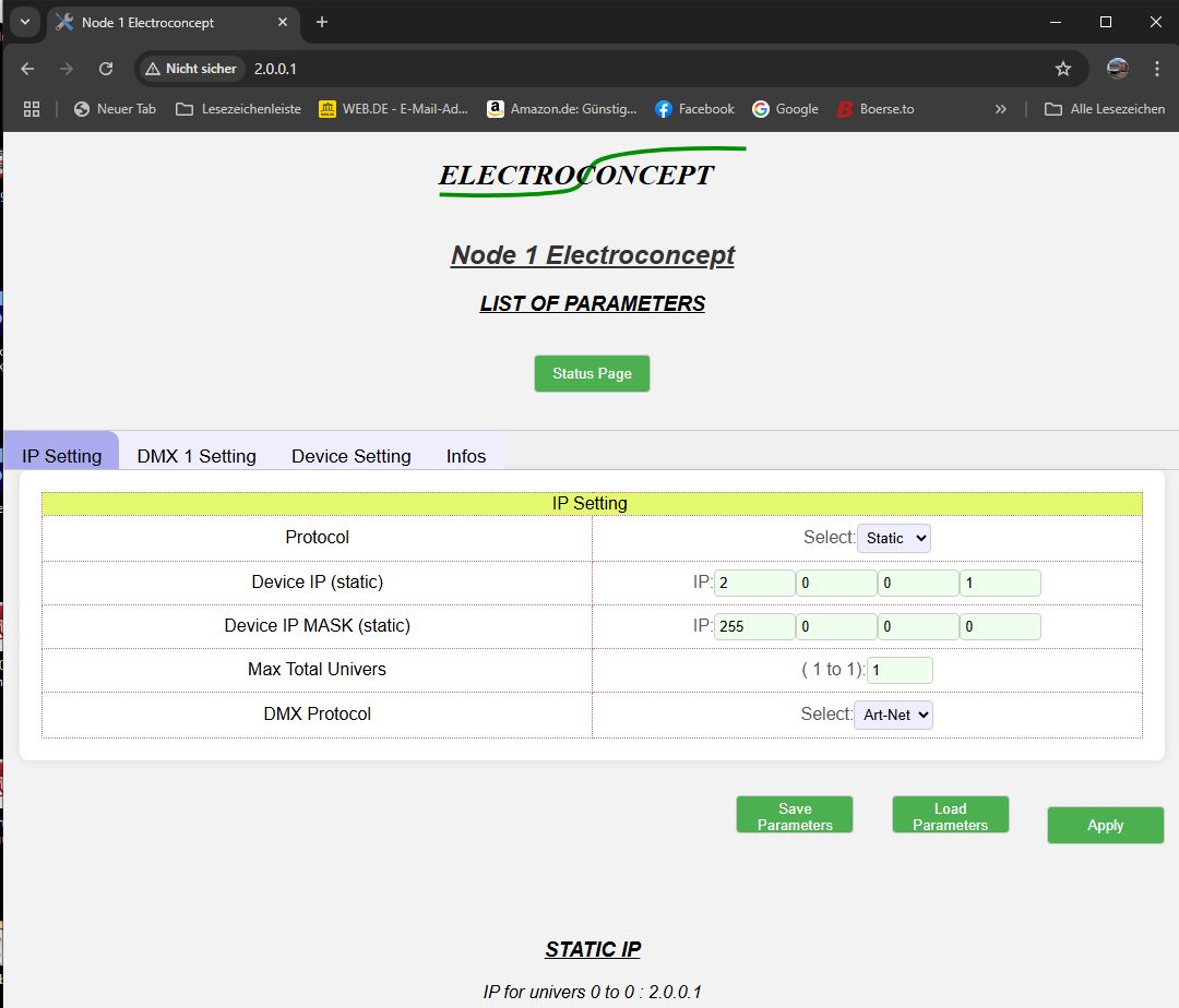

Hi, and thank you so much for the help. :) ... I've already solved the problems with Artnet... it was my own stupidity. I forgot or didn't see that I had to configure the universe in the node. But it's logical! I'm always learning something new. XD
