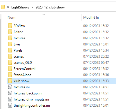

Please check my work. I have been able to open program by removing xclub file from parma file and resaving file. opened xpress and removed xclub file and reload show file from thumb drive. xpresss seems to be working with the exception of the one delated scene. Dongle now has steady blue and flashing green light now. Is that the complete fix, is software going to run stable now?
Re: corrupt show file [fixed]
So if we right understand, it works on your side too (?)
Just one remark: there is a second lightshow folder "xlub show" which is inside the main lightshow folder "xlub show". this is not normal.
