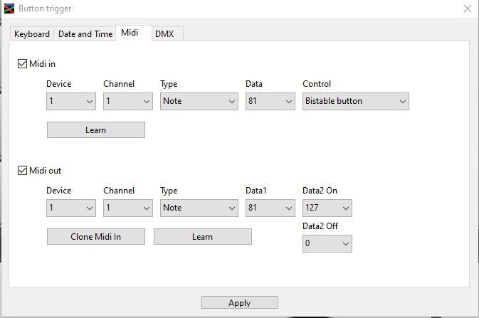

Here is the run down on what I did to make this work. Please note this worked successfully on Windows and Mac operating systems. The screenshots below show the ShowXpress settings I used. I did see some "weird" behavior on the notes that were LEARNED from ShowXpress software so if I saw a different value after using the LEARN button a few times, I looked at the note the Midi controller was configured to use and cross referenced it with an online chart. Yeah i learned more than i wanted to about MIDI but oh well!!

- Main software midi preference settings
- Capture2.PNG (14.55 KiB) Viewed 13307 times
- Live button midi trigger settings
- Capture.PNG (15.28 KiB) Viewed 13307 times
