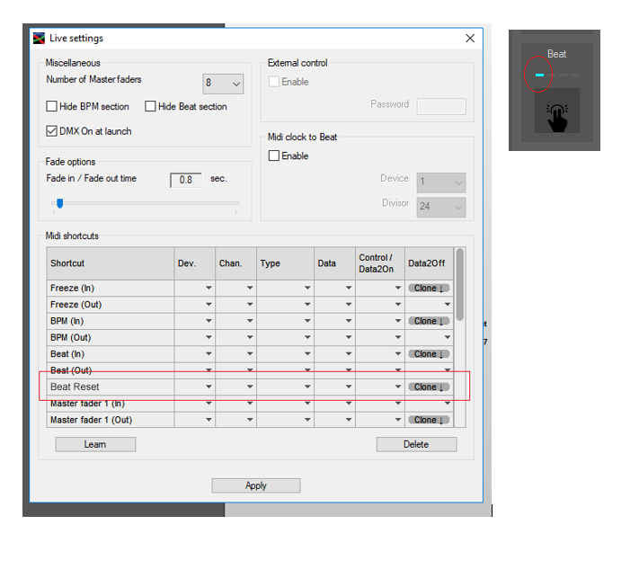

Re: Issue - No way to reset beat counter to "0" after song s
This is the best idea I could come up with as a solution without making it complicated or affecting other features.
I hope this makes sense and would be easy to setup:
