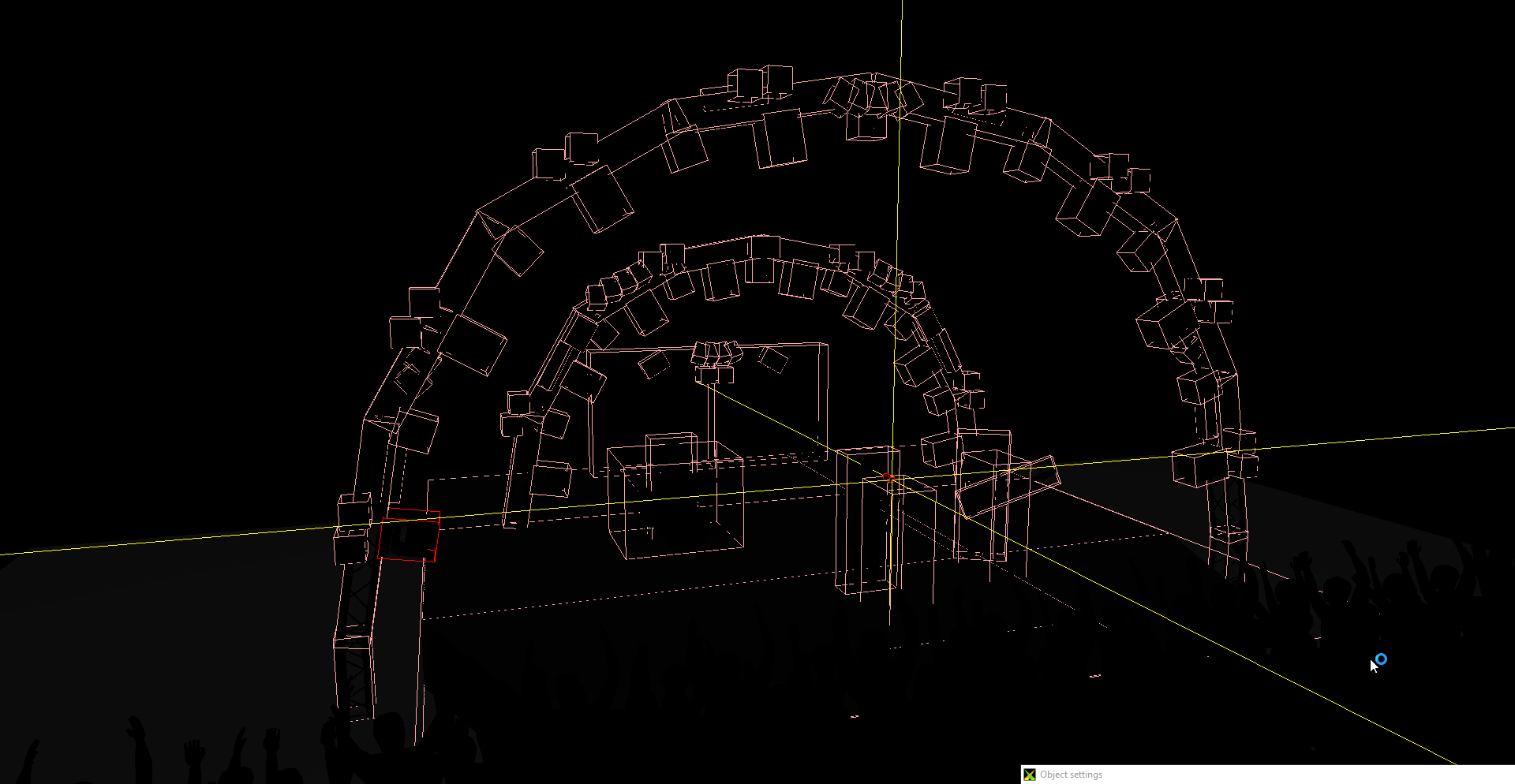

The show runs on a single DMX Universe, using 503 channels. The setup consists of 16 Beam-type fixtures, 14 Wash-type heads, 6 fixtures to illuminate the stage, 25 LED fixtures for stage effects, 26 Blinders and 5 generic Strobes.
All the fixtures are arranged on a rig of three big concentric arcs; the venue is supposed for a concert. Only the smaller arc is built using the circular truss object from the 3DView bank, the other two (bigger) arcs are actually assembled with standard 2 meters straight trusses.
Highlighting the mixture and the stage objects
Stage Rock Rings.png (64.04 KiB) Viewed 47647 times
The show plays entirely on TimeLine and required approximately 60 step scenes and 10 generator projects. I decided to edit the video with multiple cameras, as I think it does look more realistic/professional in that way :lol:
