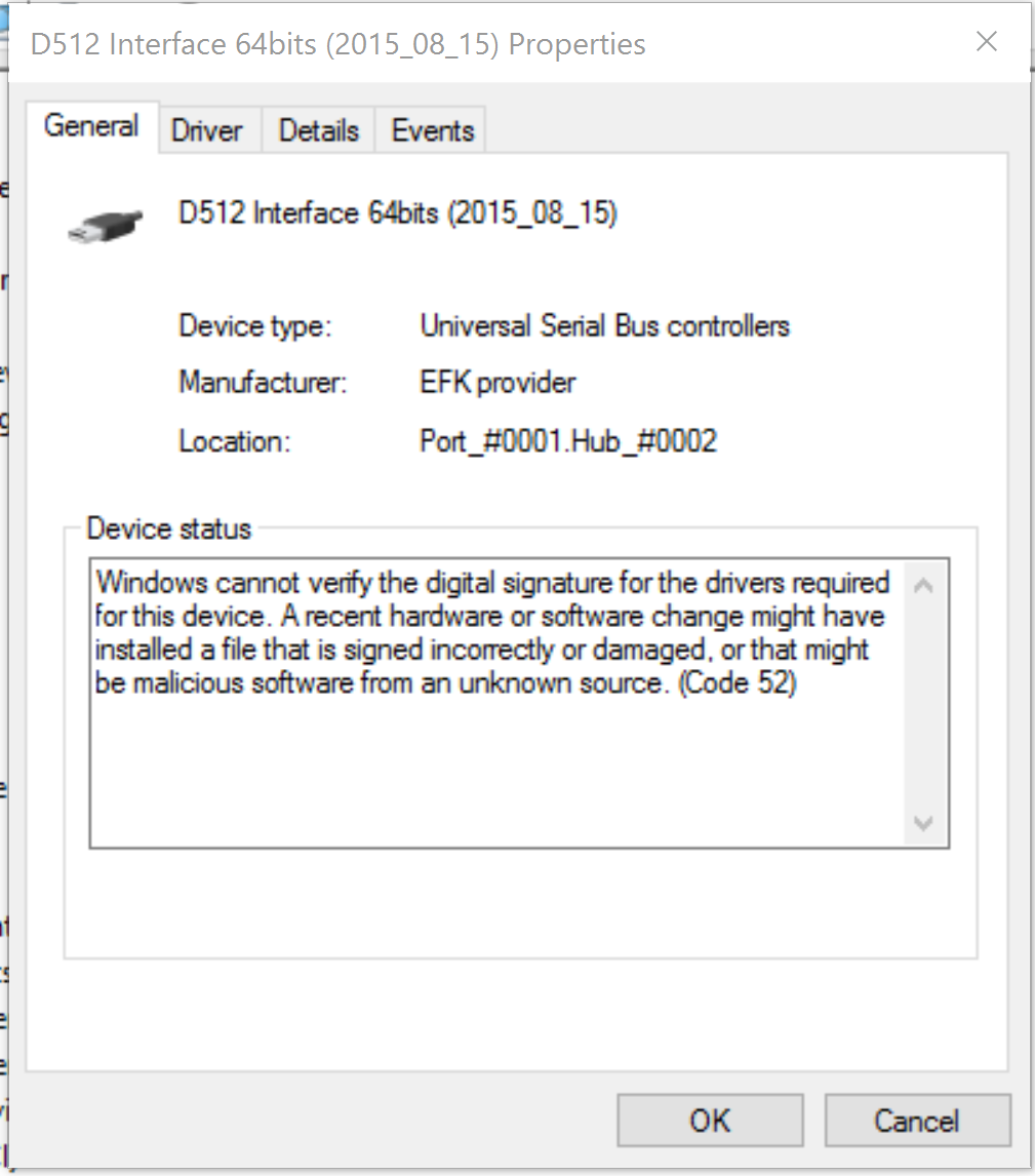

In device manager, I receive an error on the device. I have included a screenshot here.
"Windows cannot verify the digital signature for the drivers required for this device. A recent hardware or software change might have installed a file that is signed incorrectly or damaged, or that might be malicious software from an unknown source. (Code 52)".
What can I do to resolve this?

- error.PNG (192.14 KiB) Viewed 22015 times

Please proceed to a complete Operating System update.
Then the OS should be able to verify the Digital Signature.

I am running Windows 10 Home OS Build 14393.969
In Windows Updates, it says "Your device is up to date. Last checked today. 8:08PM
Are the driver and ShowXpress software compatible with Windows 10 home edition?

It appears there is one build newer than mine. I am downloading it now and will see what happens. The build no. is KB4016635.
Re: (0) Interfaces Found
I am now on build 14393.970
I uninstalled ShowXpress, then rebooted. The I reinstalled ShowXpress and answered yes to install new drivers. This still did not work.
What builds do work? What version Windows?

I noticed this information in the driver events of the device in device manager:
Device USB\VID_1069&PID_1040\8&b522230&0&1 was configured.
Driver Name: oem47.inf
Class Guid: {36FC9E60-C465-11CF-8056-444553540000}
Driver Date: 06/05/2009
Driver Version: 3.4.1.20
Driver Provider: EFK provider
Driver Section: EFKusb.NTamd64
Driver Rank: 0xFF0001
Matching Device Id: USB\VID_1069&PID_1040
Outranked Drivers:
Device Updated: false
Parent Device: USB\ROOT_HUB30\7&182537e1&0&0
It shows the driver version being from 2009.
