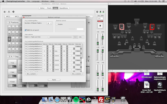

The Settings/Menue screens are difficult to get through now. Ive attached a screen shot
Screen Shot 2016-12-19 at 10.04.50 AM.png (229.11 KiB) Viewed 20418 times

It is almost always confusing/challenging to understand exactly how to use/navigate some of the new screens/menus when they come out it would be nice to have a general description for these updates. Or even have the names/tittles of buttons in these menus more direct. is there a way to add a simple help quote above a button when hovering over it?

Agreed! I thought I had a bad download or something.

Thats what I thought as well and redownloaded everything. Its hard to map out the master faders and get through these screens now......

Support...can you comment on this? Is there something on our end we need to do? It is making it very difficult to get through certain screens.
Re: V 8.2.4 Trouble
We are not able to reproduce this problem.
Looks like you have installed only a part of the software (without the recent ini files from the folder "language").
Anyway, we will release a new version quite soon ; so we will not investigate more on this.
Just install the new version when ready.

Sounds good. I reproduce when installing software and add the fix file.
support wrote:We are not able to reproduce this problem.

Same here just uninstalled and re-installed the newest, same screens.
Clgsound wrote:Sounds good. I reproduce when installing software and add the fix file.
Re: V 8.2.4 - missing translation
You have to replace the entire folder, not only the App.
