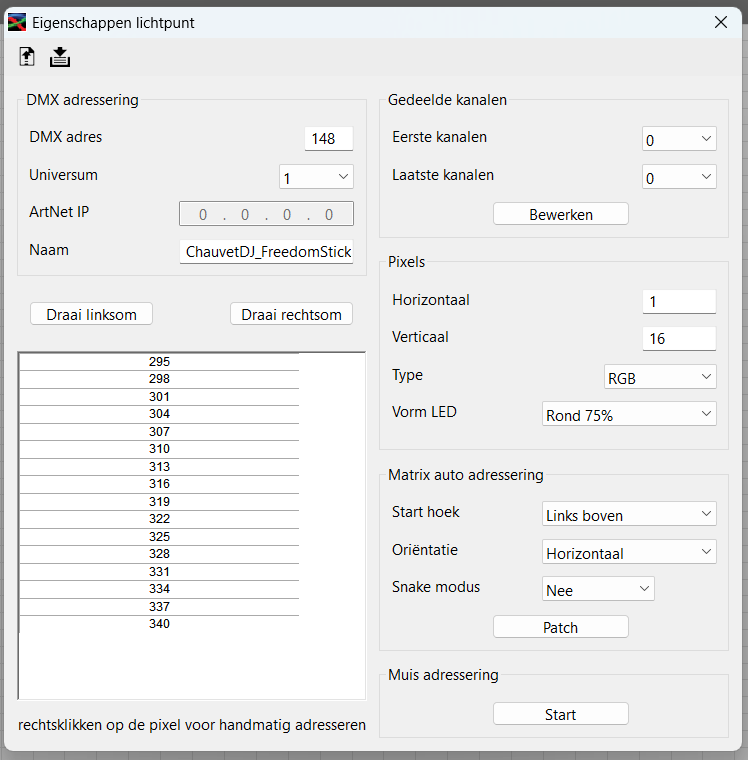

Re: pixel effects with the chauvet freedom stick x4 set?
Hi I did try
Nice pixel profile. Great!
Question: I have 48 channels : chanel 148 Red 149 Green 150 Blue ..... ... 195 blue.
If i check pixel profile it is more dmx channels.
One freedom stick begin by adress 148 and end by 195 dmx adress. 48 ch
How it works?
Press "Start" to re-address all the LEDs.

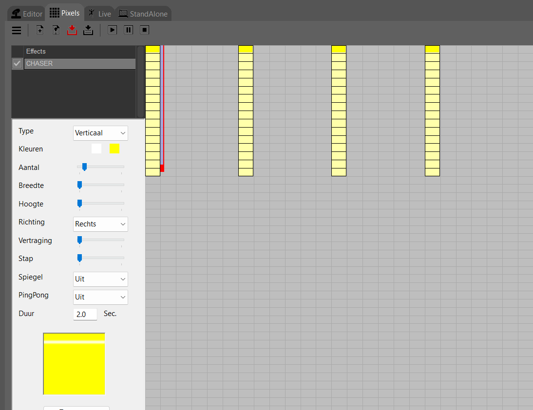

If i make a pixel pattern by pixel tab then the pixel leds are working. only the problem is the leds are stroboscoop. Not 100 % on but blinking stroboscoop
- Schermafbeelding 2024-10-13 105427.png (30.88 KiB) Viewed 105177 times
Please confirm that your Chauvet Freedom Stick are in mode "48 channels" and not "50 channels".
If yes, please post a video showing the strobe problem.
Hi
I saw also a pixel profile freedom stick 50 ch. I use this for pixel effects . Freedom stick 50 channel configured.
I like also to use the dimmer and strobe with scène screator.
By pixel editor use the pixel not the dimmer and strobe but the freedom stick make the pixel effect but in strobe effect.
I dont know what to do
