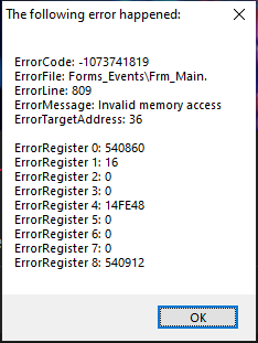

Sorry for the long layoff, but I'm finally getting back to solving this problem.
Here's the error message provided by the debugging console when the crash in question happens.
[image]
[image]
