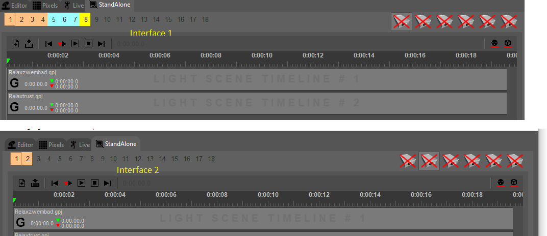

Hello support,
I think I was nt 'quite clear.
We are looking in "StandAlone" tab in the software.
We uploaded a scene on the timeline for interface 1 (so with button 1-8 universe 1&2 can have 8 scenes).
then we choose the second interface.
On the timeline of interface 2 the scenes of interface 1 are visible.
Then, it is possible to change scenes and upload it to interface 2. But if interface 1 is choosed again, scens of interface 2 are then available.
Regards,
Laurens

Re: Multiple Rack1024 4 universes
All interfaces must be connected when you press the "Upload data" button.
In this example screenshot, two dmx interfaces are connected.
And each software universe of the timeline will be uploaded to the correct dmx interface.
And before upload process, you have to select each dmx interface (at the upper right corner of the window), and configure its buttons settings.
You are correct. Uploading is also working.
(In my screenshot the interfaces where not connected).
But the question is:
if buttons 1-8 on interface 1 are pressed (in the software not on the device), in timeline are the corresponding scenes visable.
if interface 2 is choosen, and buttons 1-8 are pressed you see scenes of interface 1 in timeline.
then when choosing a new scene to button 1 on interface 2, this one is visible on timeline with interface1.
So, I think the timeline in standalone tab, is only corresponding with buttons, and not with interfaces.
Regards.
Laurens
Yes, there is one timeline per button. And this timeline is for all dmx interfaces.
It is effectively not easy to see the selected button, so it is advised to press again the button you want to select, after selecting the interface.
