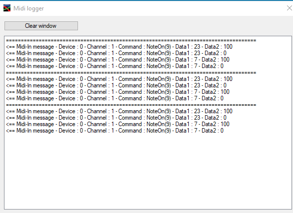

I read your post about MIDI off. It looks like the correct midi messages are getting sent. (See attached log)
I now have my actual lights hooked up with a Xpress 100 cable (I only have two light fixtures, T3's) and the performance is much better, but still not perfect.
The good news is that all the simple, infrequent midi messages are on the money... in other words, the lighting changes in exactly on the beat as expected.
The lightening flashes work about half the time. Here is some data about that:
The song has a 112 BPM tempo. The Note On for the white flash is note 23. The note length is a 1/128th note so there is a NoteON(23) Data2=100 followed by a NoteOn(23), Data2=0 0.0042 seconds later.
Perhaps the glitch is because of the NoteOn() Data2=0 happening each time? Is there a setting to ignore the Note Off messages?
In the mean time I'll see if my DAW can make a midi file without any note off messages... I kind of doubt it, but we'll see.
-John

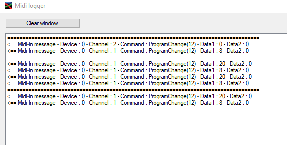

Here's the MIDI log now using program change messages...
Annotation 2020-04-27 222301.png (14.07 KiB) Viewed 18259 times
