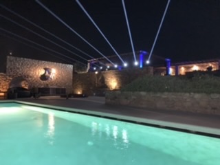

I want to have the possibility to create fast symmetrical scenes. Example we have 8 moving heads and we want scene like the photo below. For example to create it now we put the same value in tilt and we put the value 100 - 110 - 120 - 130 - 140 - 150 - 160 - 170 in pan value for 8 moving heads. I want to ask if is possible to have one generator and put there the middle value of tilt (in my example 135) then to put the step between the moving heads (in my example 10) and the generator to create automatically the values in moving heads.

If it's just a static look your looking for that's easy to edit from job to job, then just use generator.
Editor > Generator.
Select your MH, check the Pan/Tilt channel on the left. Remove all but one point from the begynning circle.
At this point you should only have one point for Pan/Tilt
Now, right-click on the Pan/Tilt/uPan/uTilt channel and select "Generator Fixtures"
Select tab Pan/Tilt offset, check "Fan pan offset"
And off you go. Drag fixture 1 to right, and fixture 8 to left. Done
Once done, just close the popup window, hit Play and then Stop to see the fixtures positions. The little square is the marker u can use to move the center.
