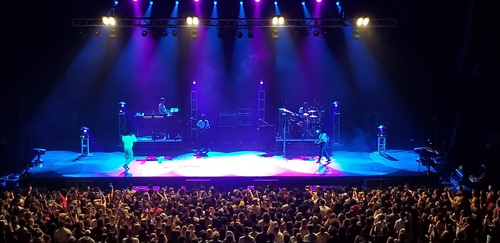

And BTW, I'm not some idiot rookie. I've been a self-employed freelance lighting professional for 30+yrs and answer more questions than I ask.
Here's a pic of my last arena show on 11/2.
Hertz Arena Miguel.jpg (191.46 KiB) Viewed 26422 times
I do thank you for being helpful.
