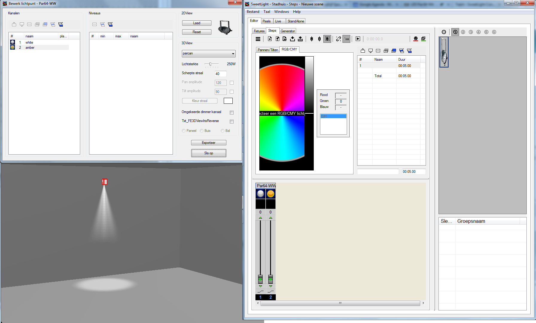

I got a par 64 fixture with 2 channels, cold white & warm white.
http://www.highlite.nl/Shop/Products/En ... _id=116165
When I added the fixture i used the colors white and amber, but when i look in 3d view, the lamp is always on (white).
It should be like this, when i move fader1/dmx ch1 up, i want a white beam, and when i move fader 2/dmx ch2. i want an amber beam to show. And ofcourse i can mix the 2 channels.
But whatever i do, only a white beam is shown and it aint dimmeble. Strangely enough, when i use RGB colors it works fine. It works even when i use White and Green, or Amber and Green, but not White and Amber.
What am i doing wrong? I have this a few years already, so i'm looking for a solution.
regards,
autogedrocht
edit: added a picture
Posts: 11425
Re: Warm white & cold white are shown incorrect in 3D
Sorry but 3DView is presently not able to manage "warm white" and "cold white" channels.
Problem noted.
