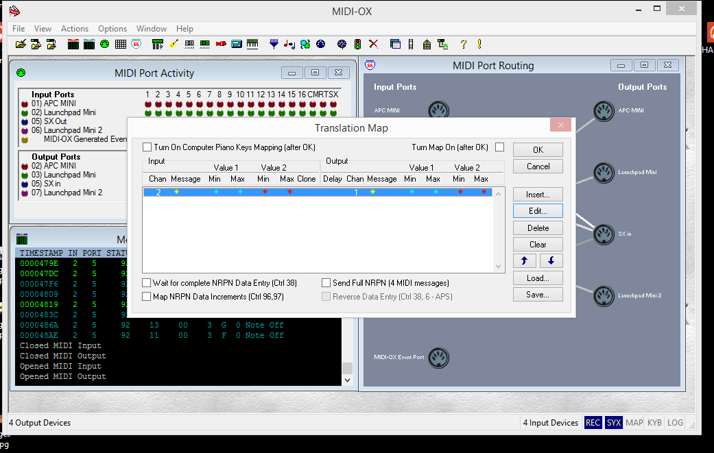

This may help... here's mine...
You'll need to create some Midi Transform maps on Midi OX that will transpose the midi channel for each controllers in and out...
I suggest you dont use channel 1 since the controllers are transmitting on Ch1 already....
1 map per input, another one for each output...
Re: Using MIDI-OX! Step by step guide?
How on earth do i create midi transform maps and how do i change the input?Earl Harvey wrote:This may help... here's mine...
You'll need to create some Midi Transform maps on Midi OX that will transpose the midi channel for each controllers in and out...![]()
Translation Map
- Translation map.png (94.48 KiB) Viewed 30757 times

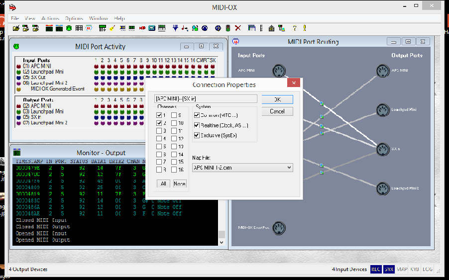

Earl Harvey
- Posts: 224
- Joined: 18 June 2012, 12:09
Check connection properties box...
add correct map for controller...
- Conection properties.png (98.23 KiB) Viewed 30756 times
Do I do this to all the devices then? So id have one that says "2" and the other that says "3"?Earl Harvey wrote:Translation Map
How do i then apply this to each device?
