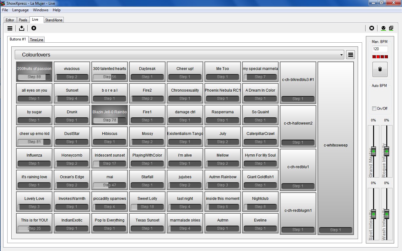

Live screen from my project that I call "La Mujer". Most of the color scenes are derived from a website called http://www.colourlovers.com/. I have tried as much as possible to present the names exactly as they appeared on the site. Look 'em up and send some love.
After creating the scenes using Pixels, I open them in Editor and add color wheels to them. It is important to apply color selections to all steps. These scenes control RGB and CMY fixtures in the array including Mac 300's and Studio Spot CMYZ. See my post in Pixels which explains how I do this.
http://www.spiffsmpo.com/LightingDesign.html
Here I have provided a link to "La Mujer" as it currently exists. Rogue 2's are having trouble displaying properly because of dual color wheels. I hope this can provide some insight into the power of layering.
Colors patched to knobs on APC40.  columns are knob groups.  rows are knob.
La Mujer Color.jpg (210.1 KiB) Viewed 54310 times

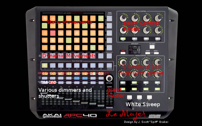

Here is a general layout of current control surface, the Akai APC40. I am also looking forward to trying to integrate with a Midas M32 soon.
Live screens are designed primarily to help find the controls on the surface.
General layout of current control surface.
La Mujer APC40 layout.jpg (56.79 KiB) Viewed 54305 times

Hey DJ Spiff...
I'm really interested to learn how you are able to assign the same knob for multiple functions. I also have an APC40 but outside of use with Ableton, I don't know how to change "banks" for the knobs... I assume that is what you are doing. Any guidance would be greatly appreciated. Thank you much.
Sean S5
