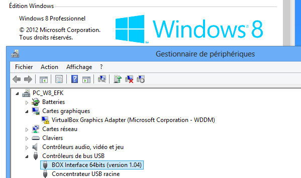

We just checked.
It works here.

Re: X-Factor (the Box) on Windows 8 64bit?
Posted: 24 April 2013, 08:43
