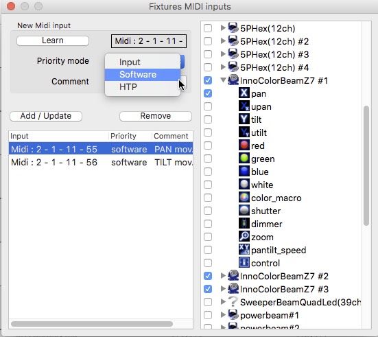

"Hard Midi and DMX patch" is only present in V8 for compatibility, it does not manage multi midi device inputs.
In V8, you should use the "Fixtures midi inputs" from "Editor"=>"Fixtures" module.

@Niffo: Thank you!
Just tried it out, that is the trick!
- Fixtures Midi inputs.jpg (70.13 KiB) Viewed 23177 times
