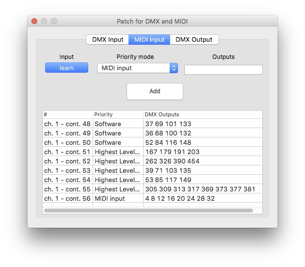

got my second APCmini today and while i thoroughly tested the power-issue with my launchpad MK2 at home and figured out it has for sure to be directly connected to the laptop or it lets sweetlight crash after an hour, what happened even connected through my caldigit-thunderbolt-station (see http://www.macworld.co.uk/review/ios-ma ... w-3499569/ ) i'm struggling now with my second APCmini in another way
My second APCmini has no power issue, but 'takes over' the button triggers made on my first APCmini, while all the buttons on my first APCmini are lit, but don't respond.
i didn't connect my launchpad in trying to fix this (see attachment).
There seems to be a 'identity confusion' when APCmini 2 takes over APCmini 1 functions and APC mini doesn't respond.
How to fix this?
How to fix this?

Bonifacedj

After ours of non-stop experimenting i got it working, twoo APCmini's and one Launchpad MK2.
I'm stuck with only one more thing now: Assigning all the faders on my second APCmini.
Managed tot assign the faders as a Midi shortcut to Master Dimmer, peace of cake.
But i can't patch the MIDI input, The "input / learn" button doesn't learn anything else then ch. 1, which is my first APCmini.
Is there a way around?
If it is not possible to assign the faders on a second APCmini, except for master dimmers, two APCmini's are rather useless.
i bought a second one for having more faders
Hope there is a way to patch the MIDI input from this second APCmini.

Have you tried the learn button and then changing either the device or the midi channel depending on how you have set it all up?

@BartHornesch: i've tried that.
As far as i can figure out now, there is no way to use the learn button and then changing either the device or the midi channel.
How would you try it?
