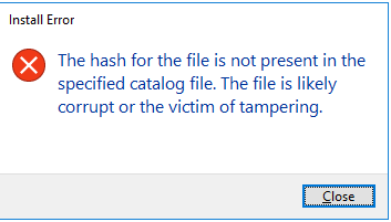

I have been having the same problem of crashing about every 15 minutes (laptop with Win10). Ricardo, in Chauvet tech support, is trying to help me, but so far no fix. Have you found a solution?
Also, attached is a screenshot of an error message I get when I install ShowXpress. This must be a clue.
The same version of ShowXpress does not crash on my tablet. Unfortunately, I haven't found an adapter that will allow the micro USB port on the tablet to operate the 512. Any suggestions on that issue?

Re: Showxpress Crashing
This error message concerns the driver installation (which is done during the software install, when you press "yes" for driver install).
It is apparently due to a catalog file which is present in the driver package. This catalog file, which was necessary with the previous versions of Windows, has now to be removed. However, it looks this does not block the driver install process. This error message will be fixed for the next complete software setup.
