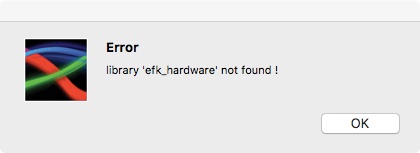

just download version 8.1.2.3 from http://download.thelightingcontroller.c ... weetLight/
dragged the folder to the desktop of my Macbook air 13inc desktop, started sweet light and got a message as seen on my screenshot. Everything is disconnected.
Dit the same on my DJ Macbook pro 15 inch, no problem.
How to deal with this on my 13 inch Macbook air, which i use for sweetlight?
library 'efk_hardware' not found!.jpeg (10.21 KiB) Viewed 18225 times

oh damned, i have to go back to OSX el Capitain... viewtopic.php?p=18778&sid=a3f8fb3da6148 ... f62ee21905
Strange, this 'library_efk_hardware not found" doesn't happen on my Macbook pro, which has Sierra installed as well.

I remember now why i was able to use the freshly downloaded V.8.1.23 on mijn Macbook Pro and not on my Macbook air this morning after the party.
On my MBP i had already earlier restored the “Anywhere” setting to Gatekeeper in Sierra with the Terminal command as seen in the tekrevue link you posted.
I'll stick with macOS Sierra and V.8.1.23 for now and will try it again at my next weekend-gig.
