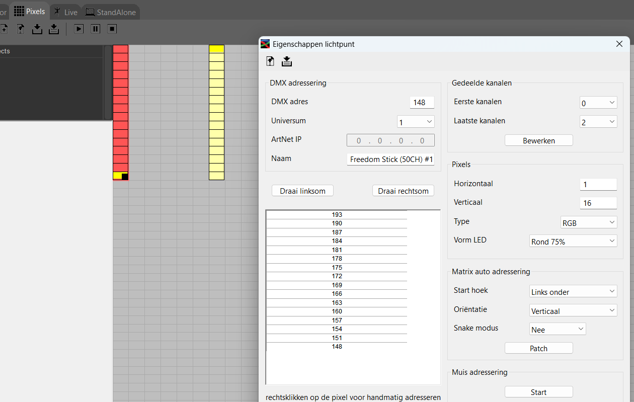

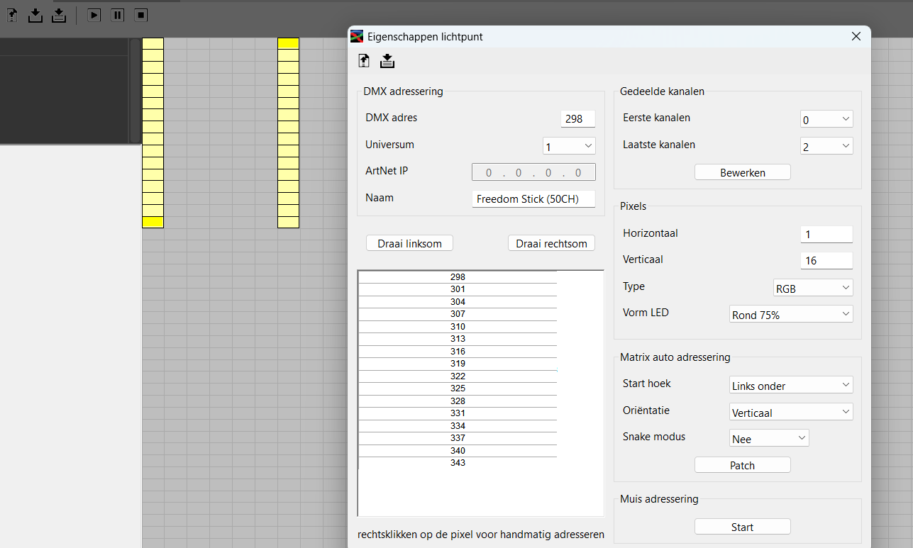

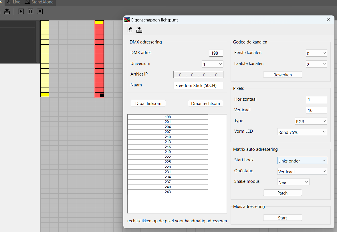

See the pictures . I think i did it correct.
I can't find why the pixel are only work with strobe when i turn pixel on

Please check that the channel #49 "shutter" is not forced to the level "strobe".
section "Gedeelde kanalen" > button "Bewerken".
You can double check that in the window "DMX bargraph".

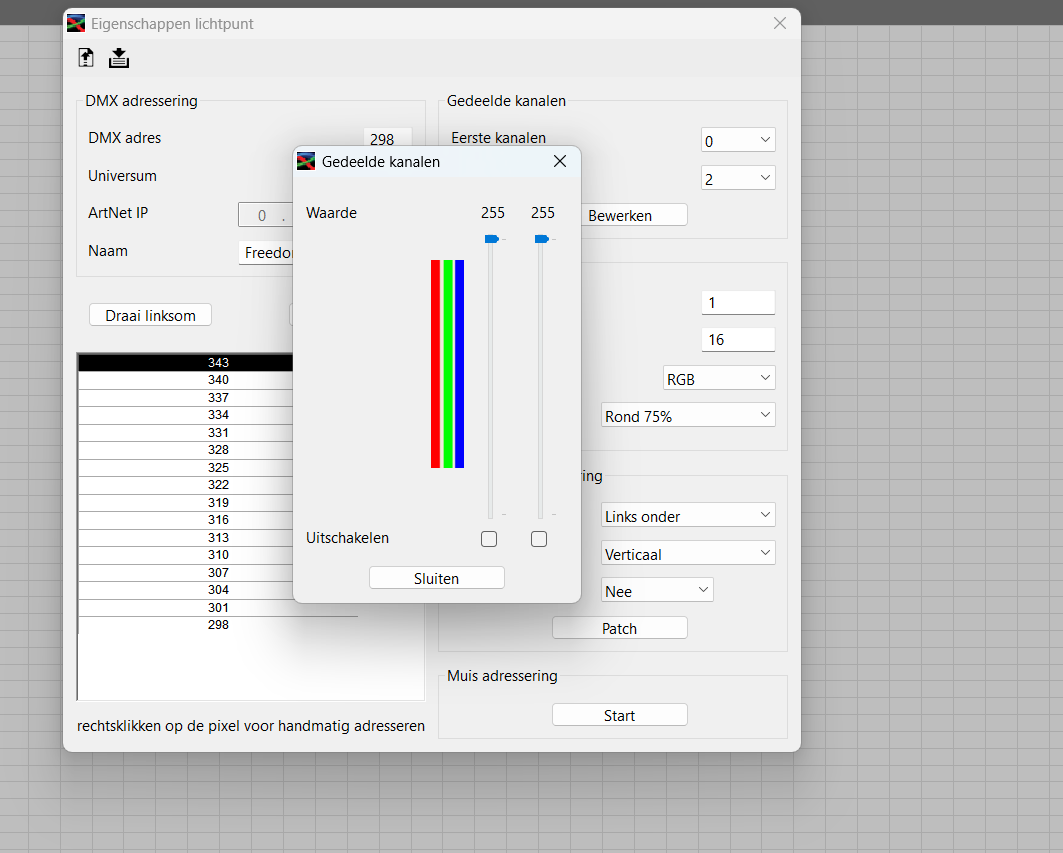

I think it use only RGB channels like the screenshot.
Shutter is 100% and Dimmer also 100% . I not use it by live control or editor. Only pixel control
shutter 100% gives fast strobe

I have to turn off the fader. I though it was a slide fader for rgb channel .
