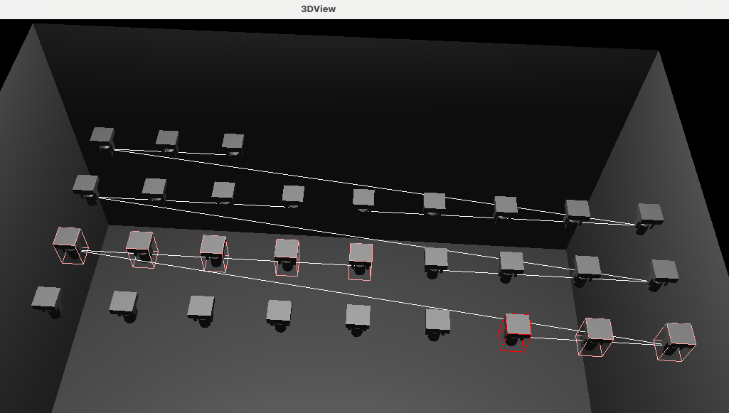

Hi I'm having issues when viewing moving head lights sometimes in the 3D viewer. There's only two of these lights patched but for some reason there's 8 total for each?
The light for reference is the equinox fusion orbit. I believe it does this with other lights too.
Thanks

Re: Issues with duplicate lights
Our 3D viewer is not able to manage perfectly multi-beams moving heads (https://forum.thelightingcontroller.com ... f=13&t=668).
Please try the attached profile. You will see only one head with that one.
FusionOrbit (37ch).txt
(1.15 KiB) Downloaded 801 times
