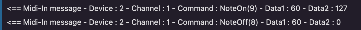

I've set a Midi note to control a channel in a fixture (Red color). When I press the Midi note the fixture lights up in red properly according to the velocity, but it doesn't go black when the note is released (note off). I've checked the Midi logger and note off value is 0.

Please tell the exact text of the "midi off" message in the "midi logger" window.

See picture.
Thank you!

Re: Midi note off doesn't work with DMX channels patch
Done for next fix file
The fix is online.
