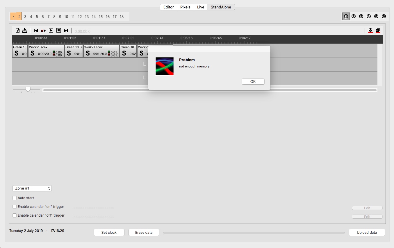

I am encountering an error when trying to upload timelines from ShowXpress to an Xpress 512 Plus interface. When the timelines are longer than 2 min I receive the "not enough memory" error.
On speaking to Chauvet they told me there was a known bug in version 9 but that version 8 should not cause an issue. Unfortunately I am encountering the same issue in version 8.
I am only trying to upload some chases for around 170 channels worth of fixtures, it doesn't seem like I should be running into a full memory?
Any advice would be much appreciated!
Posts: 11439
Re: "not enough memory" Xpress 512 Plus
It is not a bug.
It looks like the final generated scene from your timeline is too big for the internal memory of the interface.
PS : 2mn is quite big for a standalone scene
Memory used is depending of the channels number and steps number in your scenes
