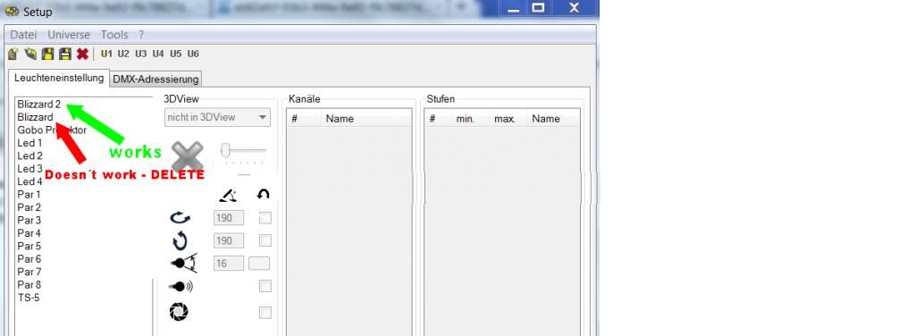

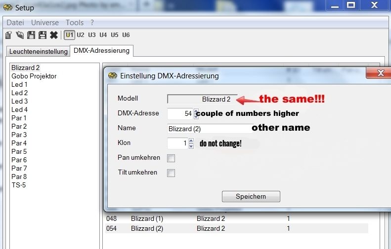

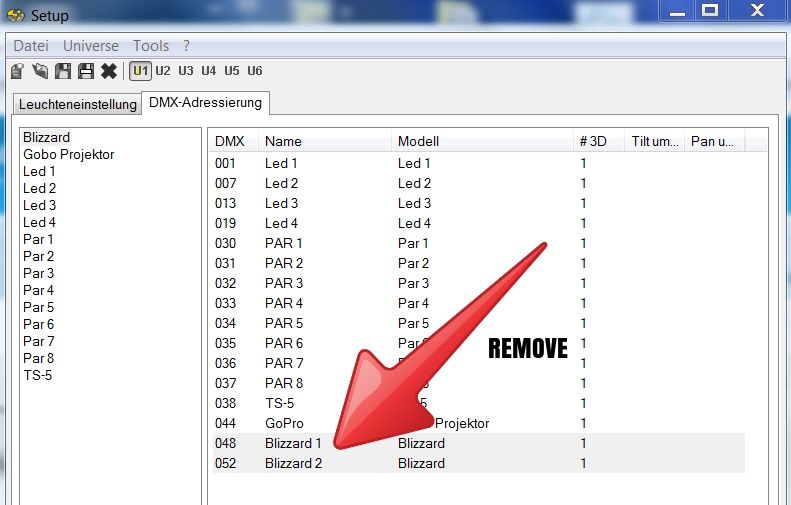

You can try this simple trick:
Before you start, go into the DMX-adressing tab in Setup and remove both the blizzards.
1.Go now in the other tab of Setup and delete the fixture that didn´t work.
2. Go back to the DMX-adressing tab and patch the working Blizzard-fixture two times in your DMX-List!
3. Open 3D-view and there should be 2 fixtures and they have got the same channels (but are still different).
You are finished! :) Now it should work as expected.
