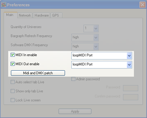

Plug your midi device to your computer
Declare the midi device in the software
open "Preferences" in the main menu" > select tab "Main"
check "MIDI In enable" to enable midi messages from the midi device to the software
check "MIDI Out enable" to enable midi messages from the software to the midi device
select your midi device in the two combo boxes

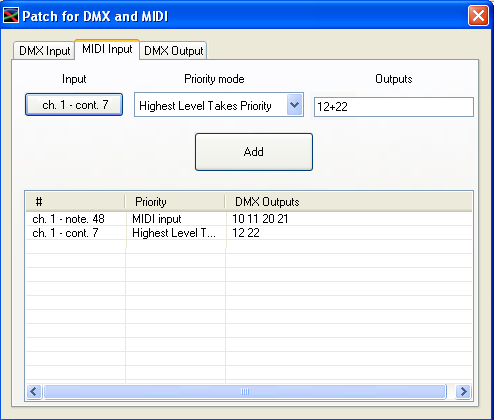

Midi to dmx outputs patch
click on button "Midi and DMX patch" button in the "Preferences" window
press "learn" and move the midi slider/button (then you see the midi infos into the "learn" button)
chose the priority mode
enter the dmx outputs, with a '+' between all numbers
press "add"

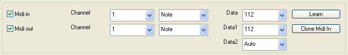

Midi to buttons in Live
right click on a scene button, in Live
select "button trigger"
check "Midi in"
Buttons in Live to midi
check "Midi out"
adjust the parameters according to the midi device requirement
